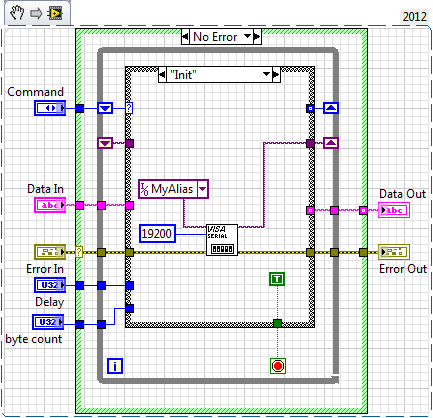

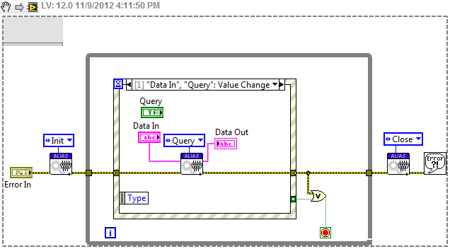

Being a huge fan of "Code it Once" and a guy who hate looking all over a large project to debug I allways create a "Resource Module" (A special Action Engine the encapulates All I/O between LabVIEW and Anything else)
Of course, you should read Ben's Famous Community nugget
The callers need to know nothing about the RM's private data since it is only used to do I/O with this device so it is the not even wired
A quickie example is shown below: as well as a example use.
Message 4 of 8
(4,943 Views)

zhm,
Those pictures in my last post are snipettes.  drag them to your desktop, open a blank block diagram, drag from your desktop to the diagram.  POOF! 1 each example provided!
