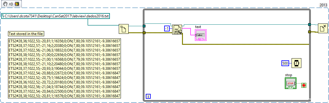

I need to get access to data saved in a TXT. I was trying to achieve that by doing something like this:
However, I only get the first line.
In this VI the indicator is just to see if the lines are being picked correctly from the file. When I get the right procedure, this strings will be passed to another processing.

If you right-click on the Read Text File, you will see an option to "Read Lines".  If you enable that and set the number to read to -1, you get an array of strings, one element per line.  If you leave the number of lines to read unwired, it will read 1 line at a time.
If this is not your problem, perhaps I am misunderstanding your issue.  From what I see in your code, it should read the entire file on the first iteration.  After that you should be getting an empty output and an error (end of file encountered).  Perhaps your indicator is only showing 1 line (ie you need to make it bigger height-wise).

I suspect the problem is the size of your indicator.  If you run this VI, it should read the entire file but the remaining lines aren't displayed because they're below the visible part of the indicator.
But, let's take a look at this VI.  You open a file that's absolutely named (I'd strongly suggest something relative), send it into a while loop where you've told it to read the entire file (without right-clicking read lines so it's looking for characters), and display the entire file to the indicator.  Then, you wait until the 500ms wait completes and try to read again.  Although, you haven't reopened the file so you're still at the same cursor point you were before.  As a result, you open the file, find the EOF, and display nothing.

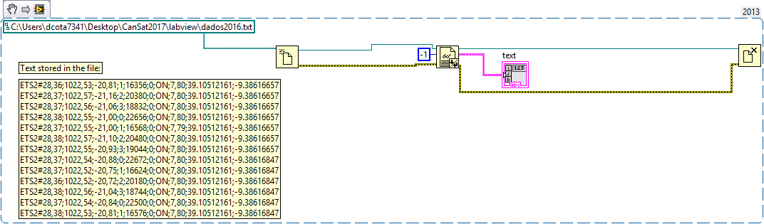

Thank you all very much!
With your tips now I have an array of strings! And yes, I do not need a loop to do this:
So now how do I get each string at a time? I was thinking about using a for loop or a while with some kind of indexing. Do you know the function to get each string?

As a tip, I'd check out: http://www.ni.com/white-paper/5241/en/  This is a course to learn some LabVIEW in 6 hours.
If you create a for loop and wire an array in as an input, it will create what's called an "auto-indexing tunnel"  This tunnel will take an element, in order, from the array to use in each iteration of the for loop.  When the array is empty, it'll stop processing.  It handles all of the indexing for you.  Topics like these are what's covered in the provided link.
