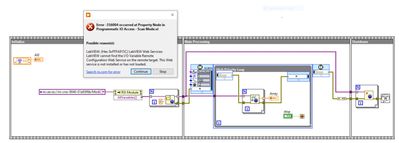

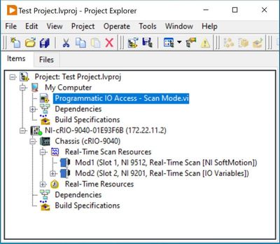

I would like to be able to access an analogue C-series module in my cRio-9040 using the shared variable pallet; However
I need the vi to run on the local PC, not the target.
Is this possible?
I modified an example vi but I am met with an error, the single variable for ai0 works fine though.

The cRIO has a separate processor running a Real-Time Operating System (probably NI Linux Real-Time) that, in turn, is communicating with the Modules that are plugged into it (as MAX is showing you).  Your LabVIEW code in your PC communicates with a separate piece of LabVIEW code that you run on the cRIO.  The PC code handles the User Interface, display, and file I/O, while the LabVIEW Real-Time code on the cRIO handles the communication with the DAC hardware.  The two programs communicate using TCP/IP, making this a very flexible, very fast, and responsive Data Acquisition and Control platform.
It is not (in general) possible to run cRIO hardware on a PC.  There are USB DAQ devices that will plug into your PC, but modules for the cRIO will not.

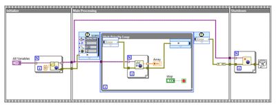

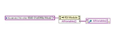

would something like this be possible, In this event I wasn't able to bind the All Variables control to the variable.
This code runs on the cRIO

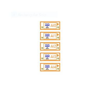

This code runs on the PC
I was looking for a more elegant solution than dragging all the individual
channel variable to the vi on the PC as below
