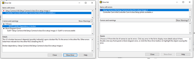

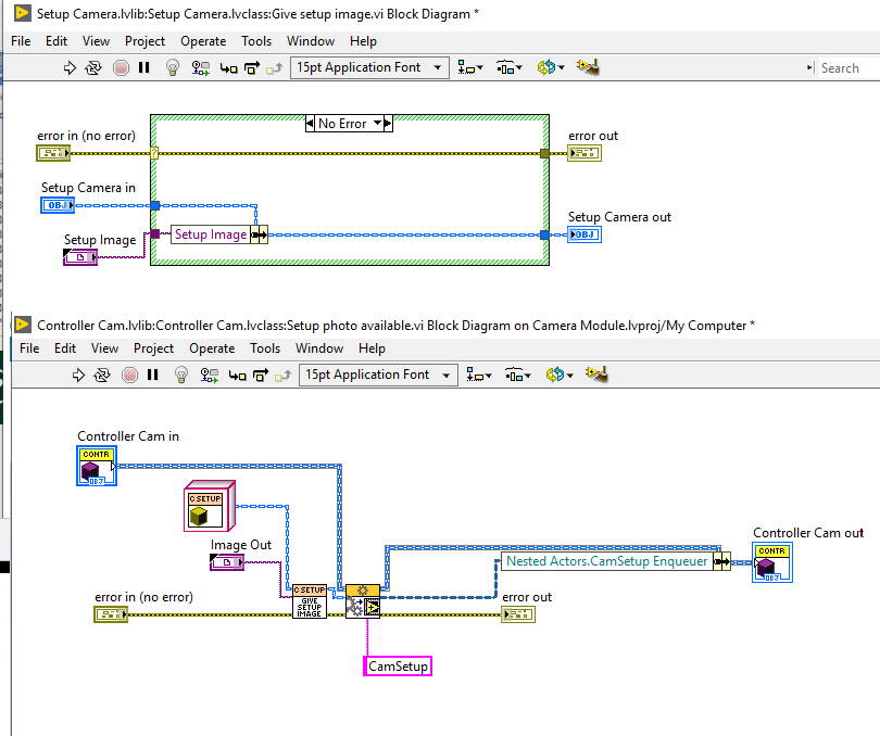

The vi writes an image to my class data, and when i disable that vi, the project doesn't crash. Originally it had no broken arrows, then following a mass recompile it did, but the error list gave no more insight as to why.
Now it doesn't have broken arrows again anymore (dont think i did anything), but it still crashes.

Part of me feels like it'd be simple to just delete this vi and pass the data in once the actor launches. Can I just do that? I suspect that's not fixing the issue though, and I don't want it to happen again.

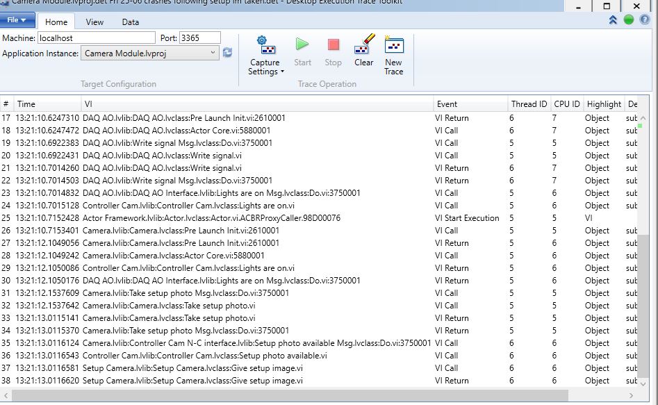

I've attached the project folder and in it the DETs that I ran. (LV20, Launcher vi is in the 'external tree' virtual folder. Running the project will crash your labview)

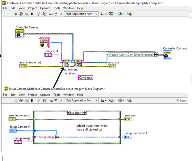

Here's the DET, the offending VI and it's calling vivis.pngdet.png Thanks in advance for any help

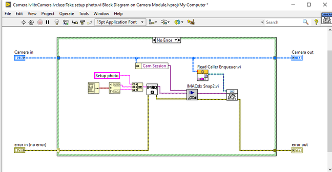

The image just comes from a snap taken by the camera using IMAQdx. So the call chain (minus the message vis) is below. The photo is taken, sent to a method which uses an accessor to add it to the class private data and then launches the actor. It feels innocent enough. The crash occurs at the middle vi which adds the 'image' to the data. I added a trace to the crashing vi following the bundle, and that executed, so it seems it is occurring on the close of the vi as the det suggests (maybe that makes sense).
Could be worth mentioning that the camera is currently the webcam of my computer, but it always has been and once I disable the bit that crashes it's still able to return images in other parts of the program.
I've never worked with vision before so there's every chance I've gotten something wrong here, but I didn't think I was doing things too differently than the simple vision examples which I copied
