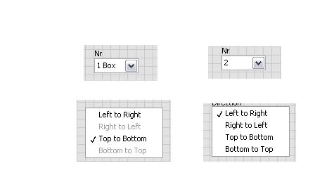

Cluster2.JPGYes I did it on the front panel. I guess you didnt understand what i want.. see attachment ps

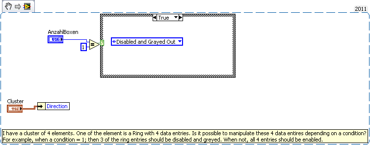

Is it so hard?
Snippets don't really work with implicit property nodes, so I attached a vi.
Message 6 of 10
(4,554 Views)

Hi
when you right click on the  ring control, you will have a Create->Property Node-> Disabled Items[]
AS LONG AS you ring control is not Strictly Type Def, or the cluster containing the ring control is not Strictly Type Defined, you can programmatically use the 'Disabled Items []' property to get the behavior.
When a condition is true, wire the index numbers of the items which are to be disabled to this propery node.
Edit: I see that dan_u has already replied, but I could not open the vi from dan_u, I have LV 2010.
so, attached is the vi as per my explanation.
Regards
Freelance_LV

Hello ,
Refer attached VI
Edit : True case: C & D are Disabled and False Case: A & B are disabled.
Ignore the comments at Front panel.
Bijay

dan_u's VI disables all the elements in direction.
Thanks to Freelance_LV. That was what i wanted. I actually didnt think of wiring the index numbers to disable.
Yes, I was showing it is possible to create a property node for an element inside a cluster. I was assuming you would find your way from there...
