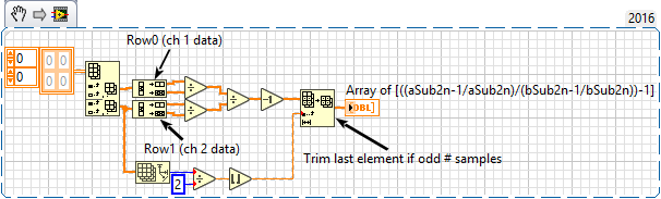

Yes, many quite more efficient means.  For example:
Divide by 2 and round down could be replaced by the quotient from Quotient and Remainder,
For Array Subset, should that wire have gone into Length rather than Index?

I'd like nothing more than for the DAQ assistant to just output the DAQ card info in an array. Is there an option to configure it this way?

Express palette >> Signal Manipulation has another Express VI called From DDT.  That converts blue wires to other data types.  You configure the express VI to output the type of data you want.
Yes,  Right Click the Express vi after you have the task configured and select "Generate Code>>Configuration and example" Grab a cup of coffee then save the vi
