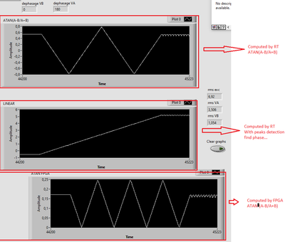

Hi GerdW,
I used your answers to find a solution and I found it.
By using my module's excitation and by recording the VS1, VS2 and excitation signal with 3 different AI of my NI9215, I'm able to compute the phase shift by myself and the re-linearize the sawtooths.
I have a little last question, you said earlier that you do the computation by you own when you acquire RVDT signals, is it possible to do it through FPGA ? Because I'm actually using some VI only disponible through the RT to compute it (RMS computation, peak detector for the phase shift..)
Respectfully;
Message 24 of 26
(1,496 Views)

Hi Henrik,
Sorry for the delay, I was out of the job during 2 months,
Your answer interests me, It seems like I can't use the FPGA to create the excitation because of the electrical limitation of the NI card, but I can acquire this excitation.
So I have, through my FPGA, 3 AI: excitation, VS1 and VS2 which I need to process to compute my angle,
My question is, how can I found the phase between VS1/excitation and VS2/excitation without the peak founder I used in my RT in order to compute the ATAN(A-B/A+B) and relinearize themselves,
Respectfully,
Simon
Message 26 of 26
