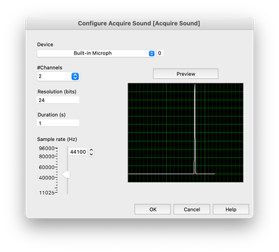

I'm running LabVIEW Community 21.0 64bit on macos 11.6 (intel) and am trying to get the Express VI "Acquire Sound" working. On Windows, I have had no issues building a test vi (with Aquire Sound wired into Play Waveform) but on Mac, no audio is being picked up.
The error codes I've gotten are 0x2A (42) and 0x12C3 (4803). Here is the configuration I used to get something, but typically running it just results in no output at all. I played around with the settings since the support page for 0x12C3 says something about the configuration not matching the hardware, but I can't say I really know what I'm doing.
 Matching 24 bit in LabVIEW to the system defaults for the microphone resulted in sometimes giving a preview that had a large spike like the one shown in the screenshot. I also matched the sample rates. A friend of mine was able to duplicate the issue on his M1 mac as well, running the same version of LabVIEW.
