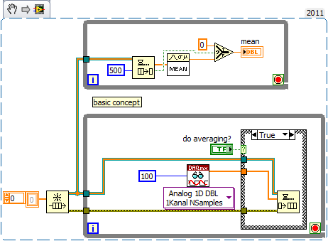

Basic concept:
  • the producer sends DAQ data into a queue when you want to do averaging.
  • the consumer reads the DAQ data and calculates the average. In case of "TimeOut" (while reading the queue) the average calculation is reset…

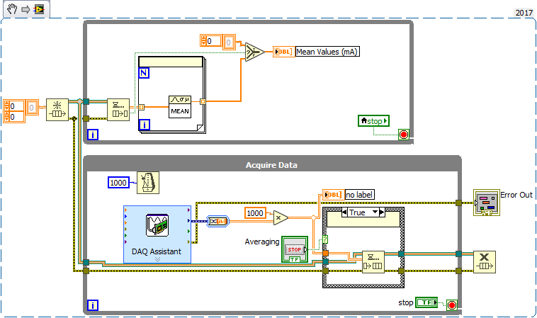

Hi Ayoob,
use less DDT wires…
When reading multiple channels with multiple samples you should get a 2D array after the DAQAssistent (instead of your 1D array)!

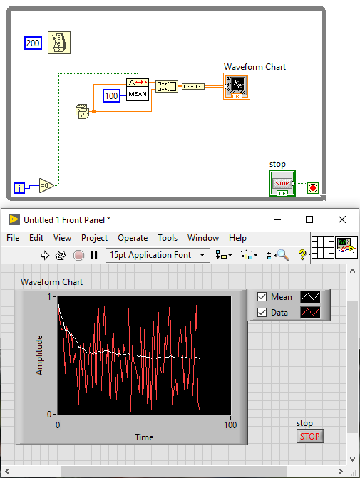

I would always compute the mean, show both in a chart with legend and the operator can select what he wants to see.
(Hint: Make the mean the first channel, looks better 😉 )
Greetings from Germany
Henrik

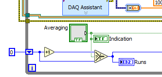

(4,415 Views)
Hi Ayoob,
again you attached your VI just for LV2019…
I implemented it using 2 feedback node.
Wow, that looks complicated!
Why not simply use ArraySize (or MatrixSize) to read the number of samples and add them up using a (read: "one") shift register?

Hi GerdW,
Sorry i forget to change the version.
I knew there will be a better way, but still i tried to find a solution of my own. I tried the array/matrix method also but did not use shift register. I will try that.

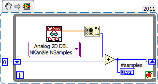

Hi Ayoob,
one shift register is enough:
Message 9 of 15
(4,386 Views)
Hi GerdW,
Im facing a problem using this method. It looks like the mean I am getting is a moving average. But what I need is a single average of all values between pressing start and stop the same like what happens in the attached program. Is there any solution for that. I tried many ways but data flow makes the program freeze at different places.
Attached is the first version I made. averaging in this version is good, but in this one when I press the stop button the live reading also stops.
