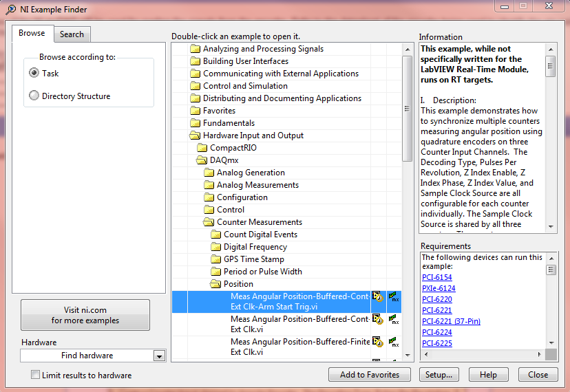

If you would like to implement a trigger, the source would be up to you, and most likely be a PFI line. Here is where you can find a great example from LabVIEW's example finder, although this uses an external clock and you will need to remove one of the counter channels:

I have tried the example and I removed one counter but it gives an error:
Possible reason(s):
Specified route cannot be satisfied, because the hardware does not support it.
Property: SampClk.Src
Property: SampClk.ActiveEdge
Source Device: cDAQ9191-16C68FE
Source Terminal: ao/SampleClockTimebase
I don't know where to connect the sample clock source.
Thanks.
Mechanical Engineer
(5,556 Views)
