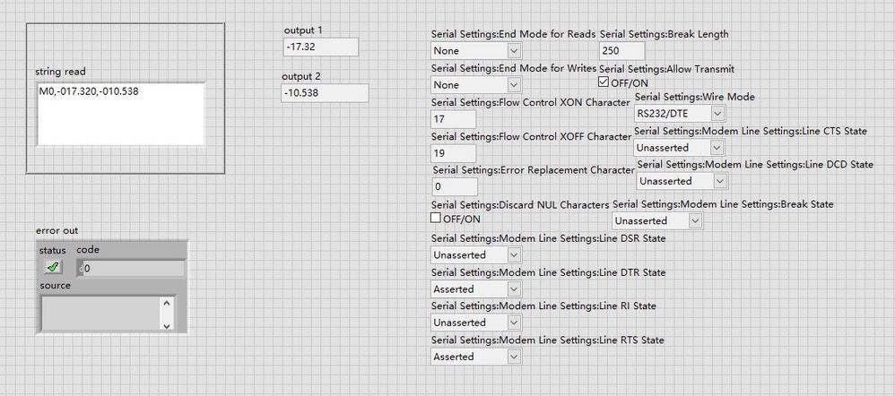

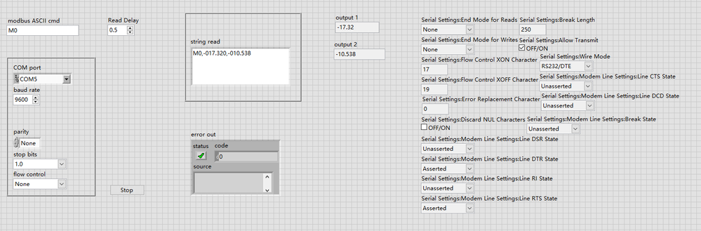

I first connected the rs232 port of the laser control unit with my PC using an RS232 to USB converter. It showed up in Device Manager as a COM port. I run my VI, and I got my distance data. The VI works as follows: First, open a VISA resource and configure it according to the laser sensor manual. Then send a MODBUS ASCII command "M0" to ask for the control unit to send distance data. And read the VISA resource to acquire the data, which has a format of "M0,distance 1,distance2".
RS232 to USB converterRS232 to USB converter
success data acquiring when connected to PCsuccess data acquiring when connected to PC

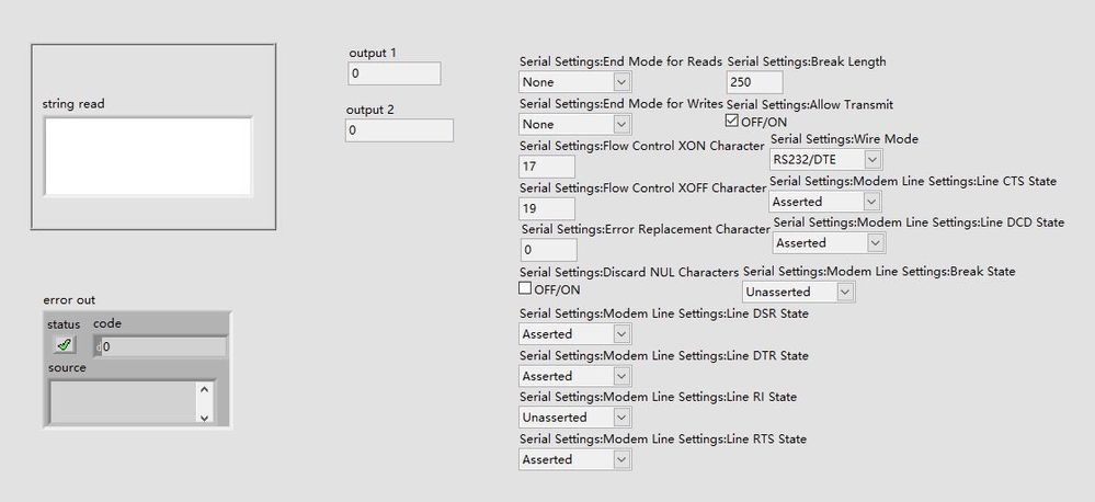

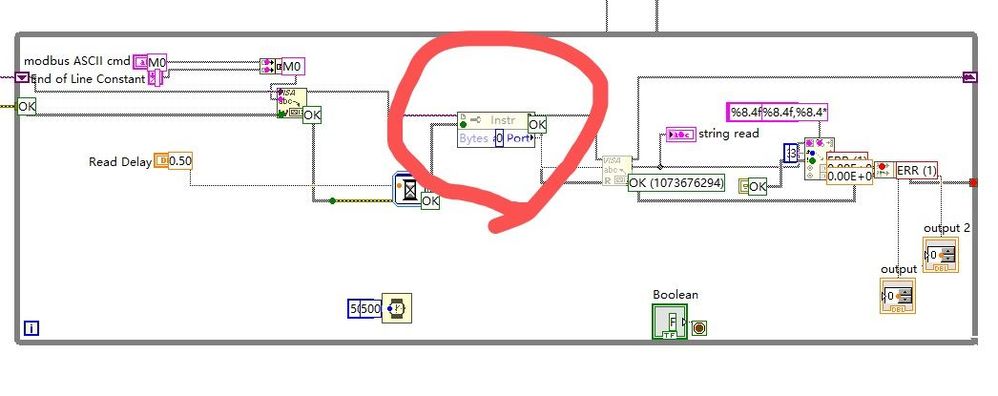

However, when I connected the control unit with NI myRIO, my VI stop working. The device showed up in NI MAX under myRIO. But after sending the "M0" command, the VISA resource has ZERO bytes on the port, meaning I didn't get any data (see the highlighted execution).
When connected to myRIO, I got zero byte of dataWhen connected to myRIO, I got zero byte of data
I thought that the I/O settings of the myRIO port might be wrong. Then I showed all the serial settings of both the PC COM port and the myRIO port (seen below). There were three differences between them: Line CTS State, Line DCD State, and Line DSR State. But I couldn't change these settings using the property node because they're read-only.
serial settings of PC COM portserial settings of PC COM port
 Serial settings of myRIO portSerial settings of myRIO port

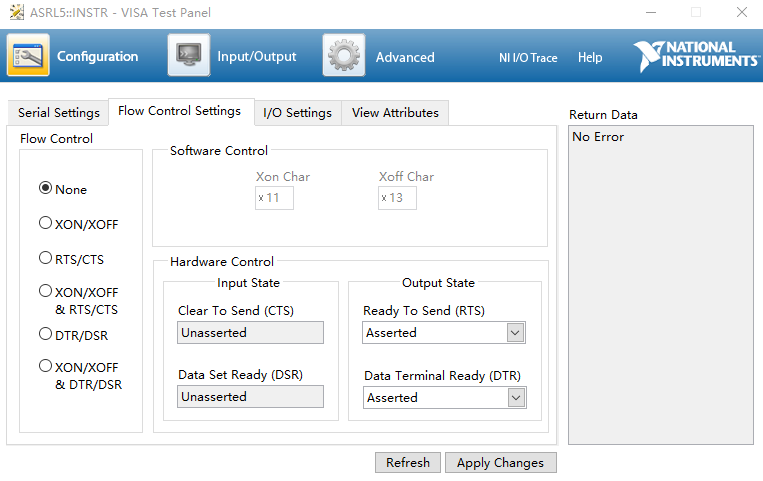

I finally tried to change the I/O settings using NI MAX. I found that the only setting differences between them are Hardware Control under Flow Control Settings (seen below). The differences are CTS and DSR under Input State. But they're grayed out.
PC COM port's Hardware Control settingPC COM port's Hardware Control setting
myRIO port Hardware Control settingsmyRIO port Hardware Control settings
