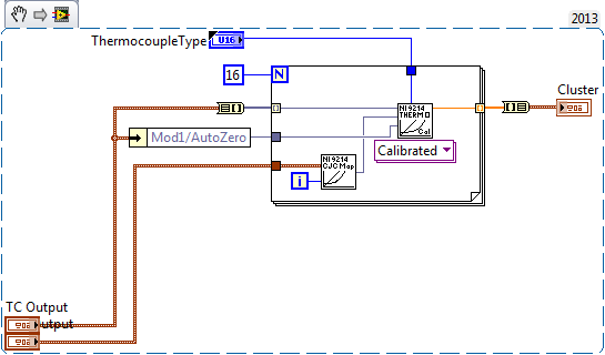

Hi Jeremiah,

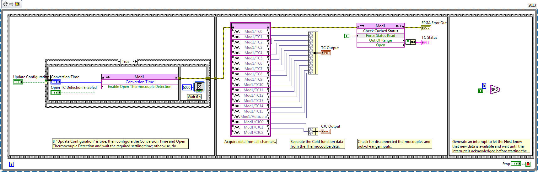

The actual target interface for this example is fairly simple: it mostly acquires data after doing some setup:
I believe you're referring to the host VI (NI 9214 Getting Started (Host))- this is where the calculations are done: Get the TC, AutoZero and CJC values and pass them through the algorithm (2 subVIs) that result in a temperature (in the snippet below the TC Ouput and CJC Output clusters are read from the FPGA Read control):
The actual conversion subVIs are all done on the host side - if you were trying to run this on the target this is probably why you were getting block diagram errors. It looks like the NI 9214 Convert to Temperature (Calibrated) function is the one you are looking for as far as getting a relevant reading out of the CJC, AZ and TC values. Hopefully this helps!
Xavier
