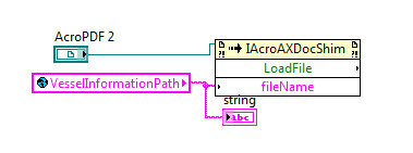

I wrote an application that uses the Adobe ActiveX element to display a PDF.
This code used to work fine, but when I updated my acrobat reader from 11.0.06 to 11.0.07 it causes the application to start very briefly displaying the icon in the taskbar but then close (without an error or warning notification).
When downgrading to 10.0.06 the problem was solved.
