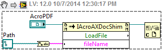

I have been trying to get PDF into a Activex Container I get these 2 screens.

It is much more helpful to see the code than to see the errors that some unknown code generates ...

Which version of Acrobat Reader do you have?
(4,455 Views)
Check the Adobe user forums. A few months ago there was a problem with the new version of Reader. I don't know if they fixed it yet but everybody was having trouble with it -- not just LV.
The solution was to downgrade one version and not let Reader autoupdate.

I have version 11.0.09 and it works with the code attached above.
