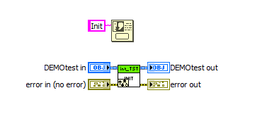

I have a Demotest Actor inheriting from the int_Test class and running methods overriding the methods in the interface, but keeping the implementation of the int_Test class.

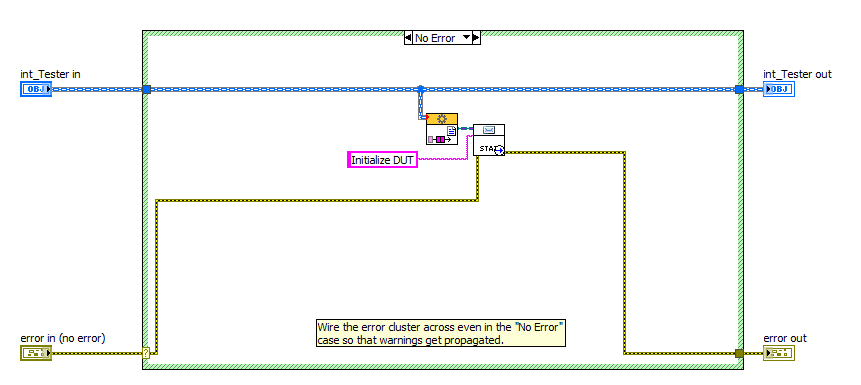

In the methods for the int_class I have a read-caller enqueuer.
When the methods is executed everything works fine, until the Demotest invokes the parent method (int_Test), the send message to the Main actor fired returns the error 1556.
I have two questions: does my implementation make the AF think that the caller for the int_Tester is no longer the Main Actor
Core?
If so, how should I handle this?

On a separate note, is there a reason why you are sending a start message with the data "Initialize DUT" instead of simply sending an Initialize DUT message?

Hi Jacobson!
Few things:
a) I did realize there is a forum for AF, but post-factum
b) I am using a Launch Actor to launch the Main Actor
c) I am using the Launch Nested Actor to launch the int_tester Actor
d) I then load the child class of the int_tester onto the int_tester class wire to run the dynamically dispatched methods over-written by the child.  This is the step when the Message Queue gets overwritten to '0' - i.e. no longer exists.  One thing is to may be make the child actor an AF as well and launch that actor as well, but even if I do that, I don't think the int_tester methods would send a message to the Main Actor any longer (when getting the caller actor enquer it will now return a reference to itself)

So what is it that you are trying to do exactly? What's happening is that you have your int_Tester actor which is a nested actor of your Main Actor so it has a caller and knows the caller's enqueuer. You are just substituting that Actor for a separate, default, actor object which hasn't been launched so it doesn't have a caller (it won't even be able to find it's own enqueuer because they were never initialized).
What I'm guessing you want to do it simply launch the DEMOtest actor instead of the int_Tester actor although depending on what you are really trying to do you may be looking to make use of the substitute actor override.
