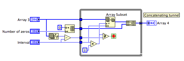

This seems to do it.  If you have an older version of LV which does not have the Concatenating Tunnel option, you can concatenate with Build Array.
I used controls for the Interval and Number of Zeros to make it more versatile if you ever need to change the parameters.

Isn't For loop better choice...??

Approach with for loop 😄
