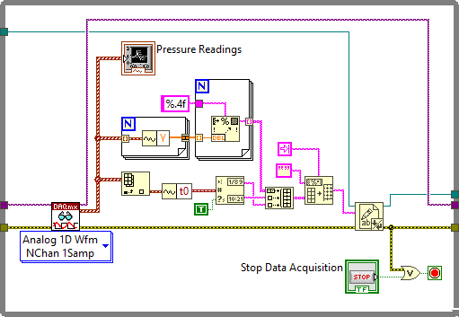

I would try using the waveform instance of DAQmx Read to get time from the data acquisition system (and to time your loop). A little rearranging of the string manipulations, and here is an implementation that may work for you:
which produces a file like:
DP1 DP2 DP3 P1 8:02:26 PM 4/23/2021
0.0250 0.0250 0.0250 0.0250 8:02:37 PM 4/23/2021
0.0250 0.0250 0.0250 0.0250 8:02:38 PM 4/23/2021
0.0250 0.0250 0.0250 0.0250 8:02:39 PM 4/23/2021
Doug
Enthusiast for LabVIEW, DAQmx, and Sound and Vibration
(1,581 Views)
