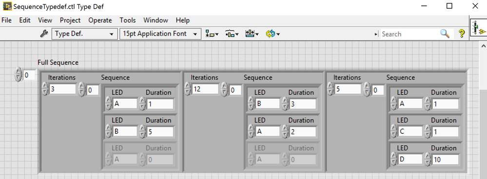

Something like this?
Message 8 of 13

Thank you for your help, but I am using Labview 2013, and I cannot open your ctrl file. It seems close to what I need.

Anticipating that difficulty, I included a picture! There's really nothing much to it. However, here is a 2013 version for you to look at. You'll still need to write the accompanying logic (perhaps using the State Machine that RavensFan suggested).
