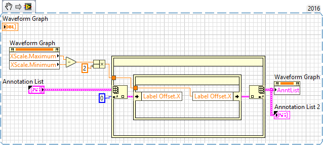

I wouldn't give up on that just yet  Free annotations (annotation Mode 0) are relative to the scale not the plot so....

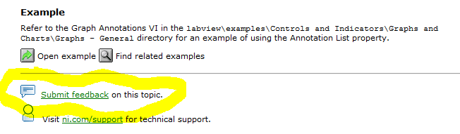

Capture1.PNGSeems to work.  Some of those annotation properties really need to be played with to see how they interact (read that as once you actually play with them while decoding the help file for "Annotation List Property" hit this button:
And share what you learned with the rest of us

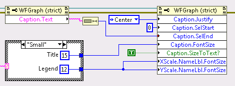

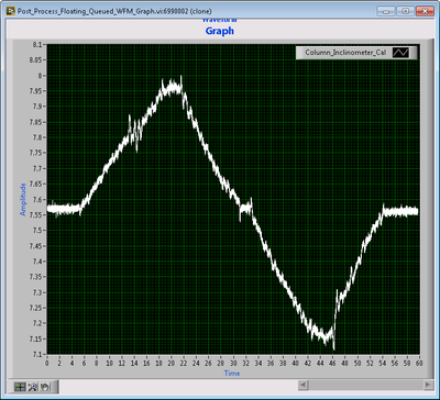

Well, I tried the caption approach and it kinda works.  It's behavior with respect to autosizing the graph with the window is a little weird.  The autosize doesn't appear to take into account the font size if it's changed programmatically (Probably has something to do with the vertical justification of the caption text).  Also, if I change the font size of a multi-line caption programmatically, only the last line of the caption changes size (Really weird... Notice the "Waveform" text winds up different from the "Graph" text below).
Results in:

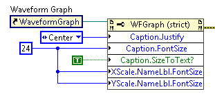

Properties that affect font, might only affect part of the text, depending on the selection settings.
Message 7 of 8
(7,521 Views)
Yep, that solved the size weirdness...
