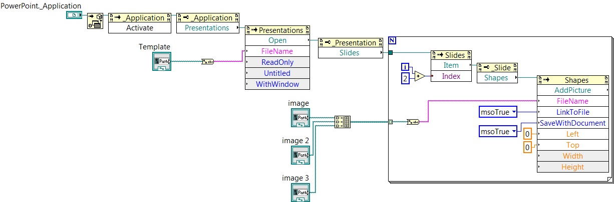

Very odd that just the 'Add' method would be missing, probably a PPT issue.  Plan B is to create a template file with a single blank slide and just open it:

Well, that worked! One cookie for you (I mean Kudo).

Kudos indeed to Darin, who initially helped me with exporting XY graphs into PowerPoint.
I followed this link to slighly modify the code to basically use a PowerPoint template (which only has one title page) and add 3 plots to it - one on each page after the title page.
I get an error that says a certain number (say 2) is out of range. Also, just like Bob who posted at the very top, I don't have the Add Method that shows Add, Index, and Layout.
I have one that shows AddSlide, then Index, then a Reference input that reads ppCustomLayout. At any rate, I want the following code to take my title page (read from an existing file)
and add the three images to the PowerPoint (I am using LabVIEW 2011 on Win 7 Pro). I don't want the plots to be pasted onto the first page (title page). The plots should start
on second page, and so on. Actually, the code shown below works just fine if I configure the template to have a title page, and 3 blank pages, but is there a way to have LabVIEW
create those pages?

If you download the snippet and put it on your BD you can make sure you have access to the same properties that Darin placed above.  I have access to them but not sure why you would not, try the snippet it should get on there.
I will try and see if I can reproduce your error.
