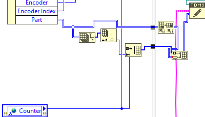

I have a 2D array with data from a sensor, the rows for example starts in 1000 but then starts to decrease cause there are no data. How can I have allways the same rows with for example 0 or NaN or something like that?
Here I have a 2D array and a counter in the first.
Why do "rows start to decrease"?
Why do you want "always the same rows"?
That image doesn't help because of hidden wires…
  • Please attach a simplified example VI to show your problem.
  • Please give expected results for some given inputs…
  • Please explain the problem more detailed! (You may even use GoogleTranslate when English isn't your first language…)

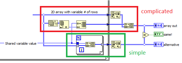

@altenbach wrote:
  • Whatever you are currently doing does not look reasonable.
Here's equivalent code (green) compared to yours(red). Both give the same result, but obviously it's not what you want.
Once we know what you actually want, we can modify accordingly.
