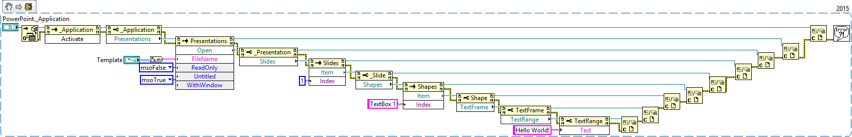

OK, I took a look at the link and used the existing code as a starting point. You won't find any Add TextBox method because there is no such thing as aTextBox object in PP ActiveX. A TextBox is a Shape Object. To acces it use the Item method of the selected slide Shapes Object. For the Item index you can either use a numeric value (based on the order the shapes were added to the slide) or the Shape Object name (which I recommend).
When you create the template you can edit the Shape Object name in the Selection Pane (Home Tab, Editing Section, click the small arrow at the right of "select" and click Selection Pane ...).
Here is a code example:

It seems you didn't try my code because it does exactly what you want: add text to an existing TextBox.
Now if your TextBox contains prefilled text you can:
1- use the TextRange InsertAfter method to append text to the prefilled text or
2- read the TextBox text using the TextRange Text property, concatenate the result with the existing text and write it back again using the TextRange Text property.
Now if you try to use method 1 on an empty TextBox it will generate an error. So even if method 2 is a very little more work it will work without error even if the TextBox is initially empty.

ERRATA: Method 1 (InsertAfter) will work even if the TexBox is initially empty. I used bad TextBox reference when I tried it and got error 97.
