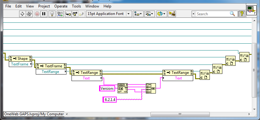

Thanks alot for the reply.. Although that works but it also change the font style of all the prefilled strings to bold and change all sub-bullets to primary bullets...I'll see if I can fix that
Message 13 of 17
(1,643 Views)
Unfortunately.. I cant seem to find a way to make the bullets and subbullets remain the same when I copy the text back in the textbox

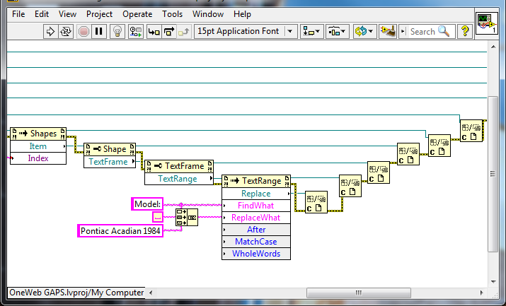

The TextRange.Replace method will not change the formatting.
