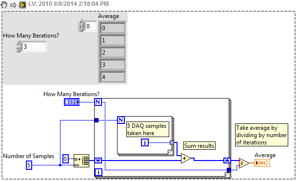

If I understand you correcty, you could use a shift register to store your final array.  Then just sum each time you calculate an array.  Lastly take the average by dividing by the size (user specified for the for loop).
This is a rough example of what I mean:
