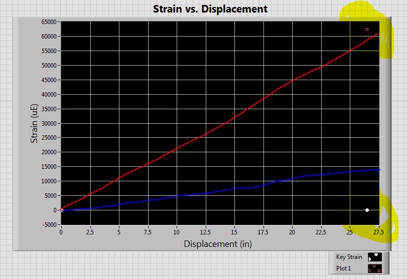

This is my current plot.  Highlighted points in the top right and left show what I can currently create, these are "live" data points.  I'd like to be able to add in the "dead" static trendlines, shown in red and blue (poorly drawn in...)

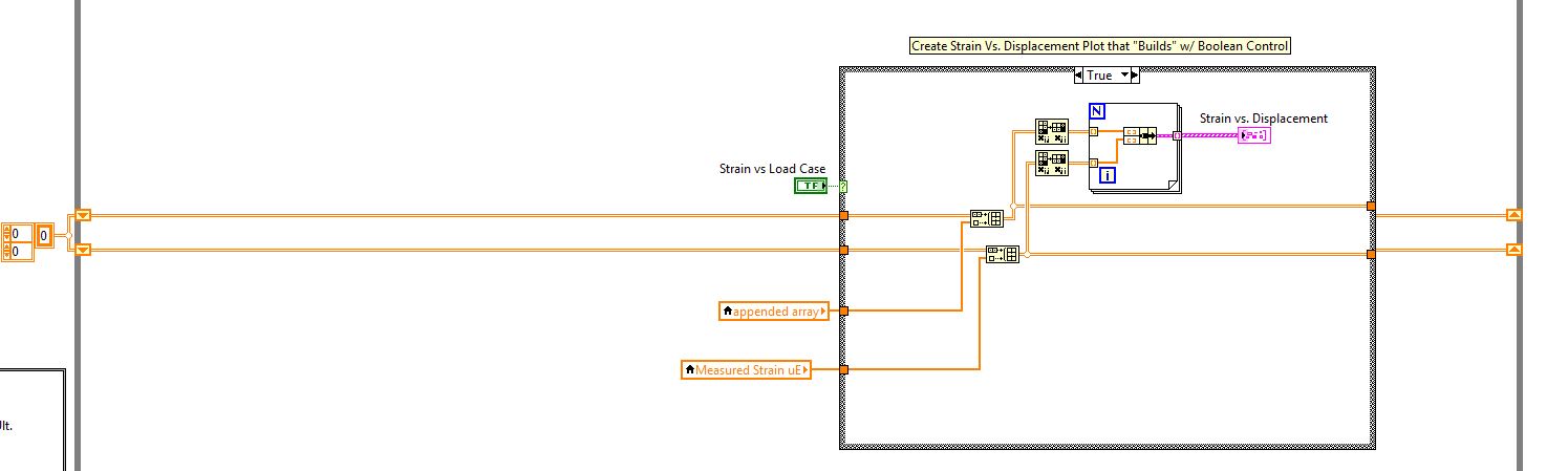

The code I have, for the plot that "builds" with the press of a button, creating the points shown highlighted in the image above:

Hi hatchling,
each plot needs its own dataset - just add it!
For your two lines you need to add just 2 points each as you use a XY graph…
