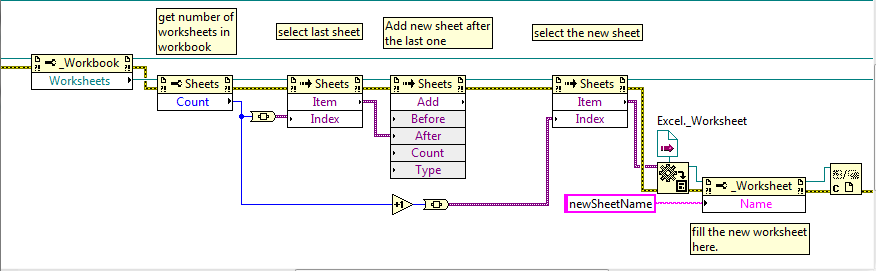

Adding a worksheet to an existing workbook is the easy part, the following code will do it:
The difficulty is the use of the template, here is how I would do it:
