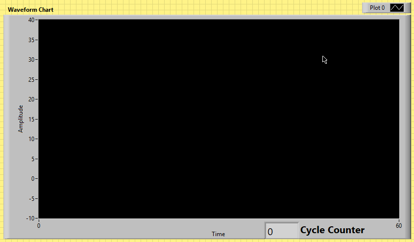

Instead of trying to display the Cycle Count as part of your Waveform Chart, just take the Indicator and drag it on the Front Panel so that it "sits on top" of the Waveform Chart, for example, in the lower right part of the chart under the X Axis.Waveform + Cycle CounterWaveform + Cycle Counter
Bob Schor
Message 3 of 16

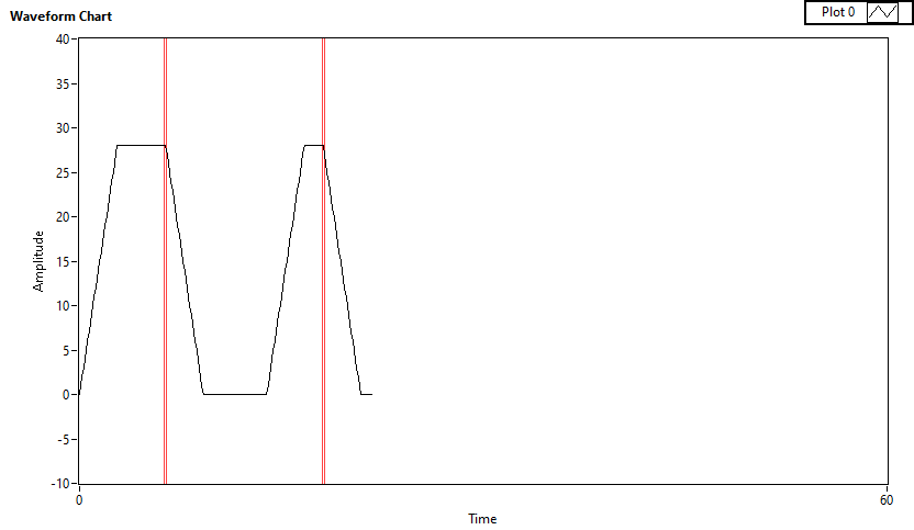

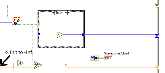

By adding the following (and updating the initial History write):
I was able to add vertical lines, like so:
which helps highlight the location of the changes to the "Cycle Count" counter. I haven't found a way to label them as they move though...
Perhaps this helps at least by showing the position of the current value as the rightmost line? (here, cycle count = 2).

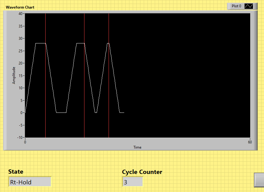

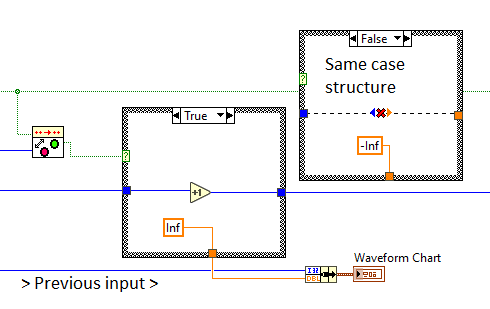

Actually, following some reconsideration, probably the following is better:
Here I added a shift register for the 2nd plot value and just flip the sign when the increment is true. This produces only a single line each time (instead of the double-line that was in the previous post):
screen capture of front panel rather than chart to clipboard - perhaps easier to seescreen capture of front panel rather than chart to clipboard - perhaps easier to see
