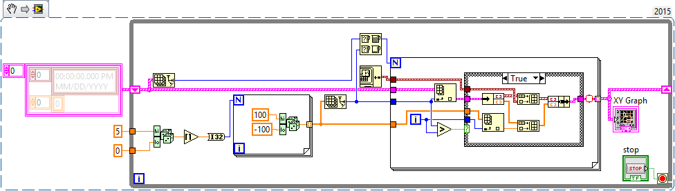

I have a source that generates between 1 and N (here 5) data points per update. I would like to create a vi that will put generated point 1 in graph 1 generated point 2 in graph 2...ect

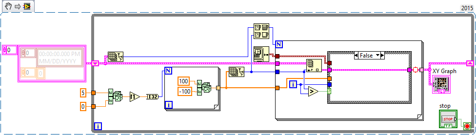

I'm not sure why, but my XY Graph clears every few updates. If someone could help me solve/optimize, it would be greatly appreciated.

Each element of your XY Graph data is a single plot. When you "receive" your data, you keep working on the same plot due to your index array, which is probably not a valid index. If your For Loop runs 3 times because the size of the array is 3, then you will try to work on the 4th plot (because 0 would be the 1st plot) which doesn't exist.

You are correct. Pesky LabVIEW doing what I tell it to and not what I mean

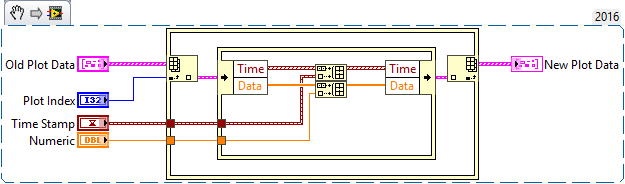

I like to use the in place element structure, just to make it a little more obvious what is going on.

However, there are definitely still use cases for the IPE. If you are accessing a DVR you have to use it. I think it makes the above situation look clearer on the block diagram, which the compiler will not help you with 😊
