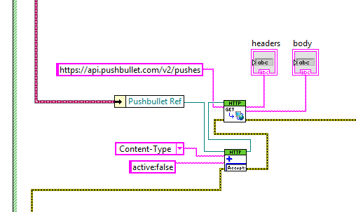

i am creating a small library to talk to the IOT server Pushbullet.  This service accepts notifications from other websites and then pushes them down to a client.  I can get a list of my active pushes with no problem, but the API lists different fields that can control how the data comes back.  See below:
if i perform the HTTP get with none of the above fields everything works, but how do i send the field data like 'modified_after' or 'limit'.  I assume it is something like this, but i just cant seem to figure out how.  I amu using labview 2014.
Somebody out there must know how!

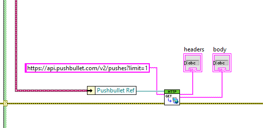

got it!  You just add the fields after the url separated with a ?.
I am sure this is obvious to some, but I am just learning!  Smiley Tongue
I hope I saved sombody else some grief...
