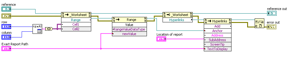

Hi Elamaran,
  To add the worksheet,you need to have the worksheet and then proceed as shown the picture below..
The location of the report input should be start with file://report path in PC.

Thanks for your effort to reply. I think you are suggesting it for Excel report.

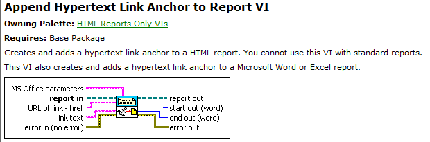

It seems that we can use the below shown VI to add Hyperlinks to a word report,
I initially thought it will only work for HTML reports.
