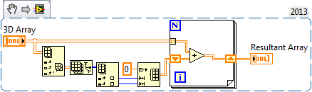

Have managed to use all basic functionalities, but when I tried to add cell(i,j) across all k's (pages) of my 3D array, I am out of wits.
Tried Mathscript, but it doesn't handle 3D arrays. Eventually, Formula Node (C) came to rescue. Logic to do this is a no-brainer, but I don't know how to do it in Labview. Have tried things ranging from For loop, Insert into Array, Replace Array, Shift Register etc.

This is one if the ways to do what you have described.
Let me know if this helps.

Here's another possibility.
Or this...

Thanks Chinmay_NI !
Neat.
I could replicate it and it works like a charm. However, I could not understand what the first thing was under the 3D array before 'array size' element. I could solve it without using that.

Thanks atnebach !
Simple and elegant. Thanks for the solutions. I tried both, and they work great.

@nskatlv wrote:
Thanks Chinmay_NI !
Neat.
Regards
The first thing is Index Array. My logic was I index the first plane of the 3D array, take its size (keeping in mind that all other planes will be of the same size), and initialize my resultant array to be a 0 array of that size. Of course, after seeing altenbach's solution, I realize all that was unneccesary.
