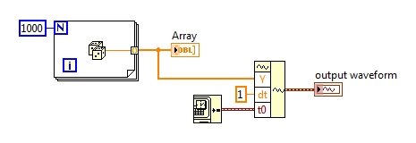

   I want to add a real time stamp with every element of a 1d array before writing to a spread sheet.
kindly guide me how to do this.

Hi Rashid,
Where is this Array coming from? Is it measurement data from a NI DAQ Device?
If so you could simply change the datatype to Waveform, where a timestamp is included.
On the other hand you could also create a waveform out of your 1D array using build wavefrom, like here:
21015i15C15D6FE4F1905C

@Christian_M wrote:
Hi Rashid,
Christian
And you can use Export Waveforms to Spreadsheet File.vi to easily write the data to file.
