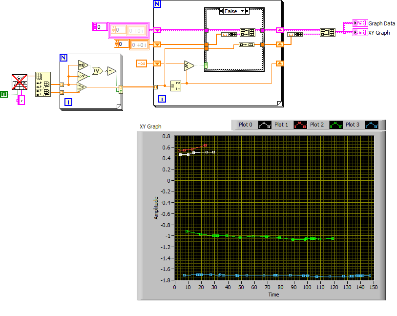

Here's one possibility:
(first loop eliminates NAN lines and such. Second loop builds each graph, starting a new one whenever the X is nonascending)
