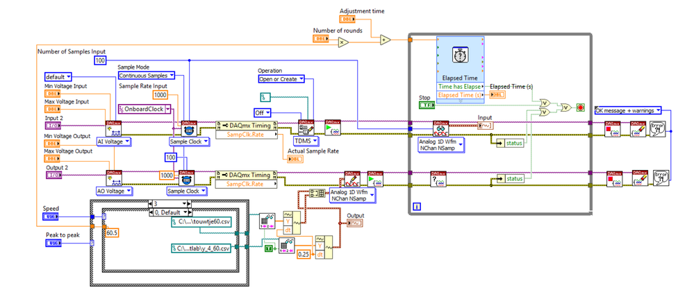

I am really new to LabVIEW. As in, I have never heard of it until a few months ago. Right now I need to work with this program. I have 5 input channels and 2 output channels. The output channels work fine. They both have different patterns but I have no problems there. The sampling frequency here is 100 Hz as I want it to be. But with the input the frequency is 10 Hz, where I want it to be at least 100 Hz. My device is able to measure at 100 Hz and I can't figure out why I can't get it to 100, since the output is 100 to the same device.
I already have tried to alter the Number of samples and the Sample rate, but whenever I alter this, I get the error 200279. Or it runs but with a lower frequency. Can anyone help me?

Why do you set a "number of samples" at DAQmxTiming? (Did you read the help for this function and the meaning of this input in "Continuous sampling" mode?)
What happens when the AI task runs in its own loop, independently from AO task?
Why do you attach just an image of your code, but not the code itself?

And I thought I also uploaded my code but probably something went wrong so here it is again (I hope).

You set a sample rate of 1kS/s and you read 100 samples per call of DAQmxRead: using simple math this gives (1kS/s * 1/100S 😃 10Hz loop rate!

I am really sorry but what do you mean with 1 kS/s? And I figured it was something with the numbers because that would give me 10 Hz. And I want to make that 100 Hz but changing the numbers gives errors 😞

"1kS/s" is "1 kiloSamples per second" - or a "samplerate of 1kHz": the numeric constant labelled "Sample Rate Input" in your VI has a value of 1000!
The DAQ device is reading samples at a rate of 1000 samples/second: how many samples do you need to read/request when the loop should iterate at 100Hz? (Again: apply simple math!)
It seems (to me) you mix the terms "sampling rate" and "loop rate": your DAQmx tasks are both set to a samplerate of 1000Hz! Which numbers do you get in the "Actual Sample Rate" indicator?
Why do you need that 100Hz sample rate at all? And why don't you set the sample rate to 100?

And I don't know if I understand you correctly, but if I delete the number of samples input and change my sample rate input to 100, I should measure in 100 Hz? I have tried this, but I get 3861 datapoints instead of the 6050 I need. This seems weird.

In the actual sample rate indicator I get the same numbers as I put in the sample rate input.
Yes, it will measure with  a samplerate of 100Hz when you set so (and when it also shows this way).
You measure as long as your AO task is running. How long will those waveforms play?
