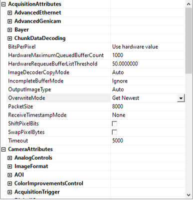

Hi All,
is it possible to produce this kind of control in LabVIEW (opt.: programmatically in runtime)?
It should be a kind of an advanced tree control whose elements are not just strings but also Integers, floats, bools and ENUMs. In ideal case it should also contain other columns that will be showing min and max values, interactive controls (tick-boxes for Booleans, list-box selectors for ENUMs, sliders for numerical values, etc.).
(just a note: Attached image is a screenshot from NI MAX showing properties of the network camera. I want to reproduce a similar functionality in one of my LabVIEW projects aimed for GigE cameras control.)
Thanks for any advice. Simple solutions are better. Complicated ones are more funny. 😉
Cheers.

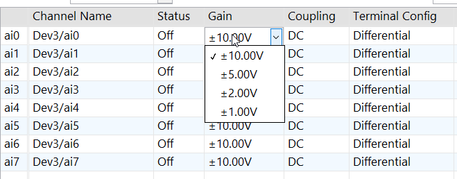

This thread, https://forums.ni.com/t5/LabVIEW/Multicolumn-Listbox-scroll-bar-woes/td-p/3984278?profile.language=e... , has pictures of what I was trying to accomplish.  You can judge for yourself whether it looked like a Tree or not. (Scroll through the whole thread to see multiple pictures)
I never implemented (4) for the control, but I often use that method for Tables. The user clicks a box, and a text ring overlays the box with specific choices. See below.
mcduff
EDIT:
The Example Finder is a Mutlicolumn ListBox with Multiple Symbols. Remove the horizontal lines, looks more "Tree" like.
