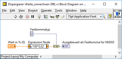

I made a screenshot of my old code, maybe it is of use for you (different module, therefore I use a different scaling):
Ingo – LabVIEW 2013, 2014, 2015, 2016, 2017, 2018, NXG 2.0, 2.1, 3.0

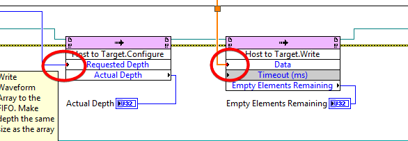

Yes, that's what I mean with the I16 vs. DBL sentence in my last posting. Did you notive the red Coercion Dots in your host VI?
They show you that some kind of "forcing one numeric format into an other one" is done. This often results in a loss of precision, therefore one should generally get rid of these dots by either converting numeric formats manually (and therefore having control of what exactly happens), or, in your case, find that the FIFO is probably set to the wrong format and fix this (:
The same then happens in your FPGA code, when the I16 value is forwarded to your FXP output (see my previous post)

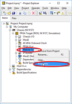

Hint: Here is where you can change the FIFO data format:
You probably want to set it to either SGL/DBL (taking your array into account), or to FXP (when you do the number conversion from DBL to FXP already on the host).
