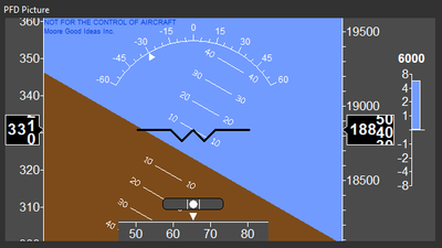

I spent some time last week getting to know the 2D picture and picture plot VIs to make a better artificial horizon for flight test UIs. My main goal, besides making it look nice, was to make a resizable control that also looked as nice with as much functionality as we would expect on transport category aircraft. What I produced is I think as good as the best of what you will find on most airliners, at least as good as any aircraft not implementing synthetic vision or terrain depictions on their PFD. The trickiest bit was being able to rotate text in a picture control. I ended up converting coordinates from a single line font to rotate and translate each number and then used the draw multi-line vi to put the numbers on the picture. It isn't perfect as x,y coordinates round into the nearest pixel, but it is fully readable.
Here is the best of what I've created so far:

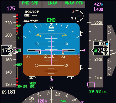

My inspirations was this, more or less, with some simplifications for ease of developing:
I have one more element to add, that being a roll angle indicator like the one at the top of the this PFD:

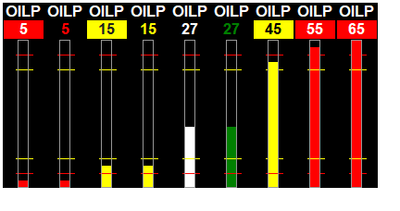

Having gained some serious appreciation for the 2D picture indicator, I am thinking I would like to tackle making some serious aerospace-grade vertical tapes and maybe eventually some dial indicators as well. I have made these vertical tapes using LabVIEW native indicators, but I am less than perfectly happy with them:
My biggest issue is that these are not easily resizable for the developer, and are not at all resizable at runtime. I also don't like that there isn't an easy way to indicate to the user where a tape will transition from normal (green band on an aircraft, white band for engineers that might be color blind), to caution (yellow), and warning (red).

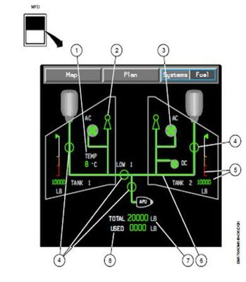

PS: My future state dream is to make a framework to build synoptic displays from a config file at runtime, stuff like this where lines change colors based on if it is an active flow path, and valves change symbols for open, transitioning, and closed, etc:

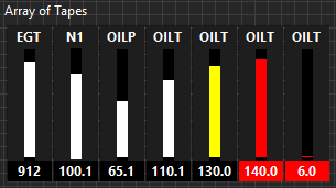

Well, tapes were easily done in picture controls:
Resize is easy:

I've found that a large picture box can bring a UI to its knees if it is refreshing fast enough.  This is because LabVIEW does not use accelerated graphics and uses the GDI to draw its stuff.  However, the alternative, the .NET picturebox uses DirectDraw, offloading the picture drawing to the GPU(s) drastically increasing UI response.  However, the .NET picturebox is a pain to implement and just the act of turning the LabVIEW video string to a .NET picturebox can limit your throughput.  Also, since the .NET picturebox is technically not part of LabVIEW, it is a pain to integrate with a LV front panel.

Completely understood about the lack of video accel on native picture controls. I would recommend a ~5 Hz update rate for mechanical gauges and tapes, probably 10 Hz for an artificial horizon. I'll do worst case load test and see how the CPU handles it.

I added a roll readout to the artificial horizon...

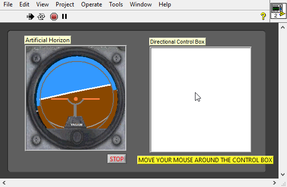

Regarding performance of a picture indicator, and how to get the most out of it, I've got a ton of experience on this front.
Was able to get 45fps on a Pentium 1 100MHz pc back in 2004 displaying a 800x600 image
As well as updating annotations on top if it.
I'd love to help you figure out how to do this and see some of the code implemented.
The tl;dr of the concept, is that the picture control is a glorified byte array and each element is an op-code, length, and then data.
I created code to keep a simple database of elements on the picture control, and then just modify the data of the specific elements.
also because it's a byte array, you can do in-place operations on the array.
That way you're not re-drawing things over and over again.
I developed that approach after creating something that should look pretty familiar.
