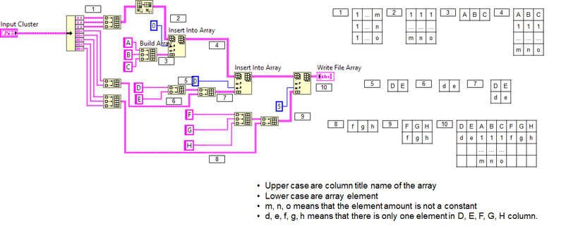

Very grateful that you may point out the cause of the problem.
The following diagram is the block diagram of my sub-vi.
I use a lot of build array vi to build a big data array for writing file.
However, I'm not very sure how to change my code with  "in place element structures" because the No.4 array is not a fixed rows array...
Could you give me more clear indication? thanks~

The classical solution to your problem, and the classical way of avoiding that many copies of arrays being made, and also where the in-place structure comes into play, is to initialize an array big enough to contain all the data you will need at the end of your process at the very beginning of your program. This way you create a single array block, that gets copied into memory exactly once, and de-facto "reserve" that memory space for all further operations.
And after you do that instead of combining different array chunks to build it (and causing a new copy of the whole thing in memory every time you do so) you replace the corresponding array chunks in the already created big array instead (i.e. doing those operations "in-place"). This means playing with a lot of array offset indexes, incrementing them, paying attention not to write data past the initial array size in any dimension, but also in case your data will fluctuate in size in time, not to use "old" data from the big array that remained there from old iterations, etc.
Basically go backwards, start with the array the way it should look at the end, initialize it this way from the very beginning, but with default values, then figure out where to replace what portion of it at each step, and make sure you end up with the correct data in it at the end of each iteration. Of course that is much easier said than done, but that is the way.
"Good judgment comes from experience; experience comes from bad judgment." Frederick Brooks

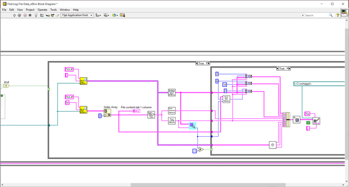

Hi Ray,
cleanup the whole code.
  • Replace all those "Call by reference" by usual subVIs.
  • Remove all those "Request Deallocation" calls.
  • Give all your icons a closed border.
  • Create a LabVIEW project.
  • Include all subVIs in your project, there are missing items!
Like this:
