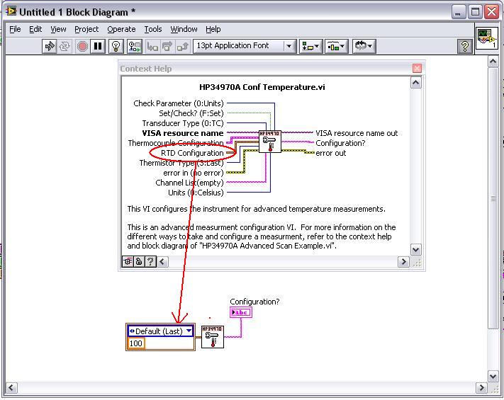

Can you clarify where you are righting 1000 ohms in the EZ Temp VI?  I looked through that VI, but I don't see where that setting can be configured. Also, have you tried using Configure Temperature VI? This VI has an RTD configuration input cluster, try changing the default 100 ohm to 1000 in this cluster.  I have attached a screen shot of this configuration VI.

Yes I am using the VIs HP34970a found on ni.com. I believe that the problem lies within a command string to the Agilent. I start with the HP34970a "Initialize" followed with the HP34970a "Config Temperature" (which I have configured for RTD, .0091, 1000ohms). All if fine until the next step which is the HP34970a "EZ Temperature" (configured for RTD,.0091). When the EZ temperature vi is run by the software it resets the Agilent to its default setting of 100ohms which results in me getting an "open" reading. I have tried writng a command string inside the EZ Temperature vi to tell the Agilent I wanted to keep the 1000ohm setting and the Agilent got mad, it did not like that. I currently have the program working by excluding the "scan list" from the EZ Temperature VI. It gives the readings I want but causes the Agilent to "beep" an error.

Why would you be calling both Config Temperature and EZ Temperature Scan?You should use one or the other. Look at the example called HP34970A for how to use the Configure functions. That example uses Configure Voltage and Configure Resistance. Your porgram would use just the Configure Temperature. The rest of the code can be used as is, I believe.
