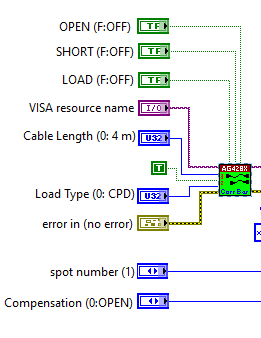

I am working on automation VI for Agilent E4980A.
I started from old sw compatible with the old LCR meter Agilent 428X.
I am trying to configure correction in the VI flow but I continue to have the following error:
Error -1074000000 occurred at Agilent E4980.lvlib:Error Query.vi
Possible reason(s):
Instrument reports:
+71,"Scanner I/F not installed"
+0,"No error"
below the old vi with the basic correction setup:
They look the same.
Do you have any idea of how to solve it?
Thanks in advance.

Hi Santo_13,
I checked also on user manual:
When Option 301 (Scanner Interface) is not installed and you attempt to switch to multiple
correction mode, a Scanner I/F not installed error message appears in the system message
area.
The fact is that I am trying to have a single mode, that's why.
Do you know any solution?
