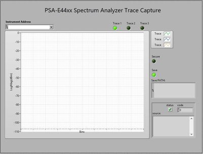

Presenting the E444x Trace Capture tool that I cobbled together from VIs I found here and probably LAVA - author's name attributed if known. This VI tool is just a trace capture tool but it adds the X axis information into a CSV text file you can easily drop in Excel. There is a "screen" capture tool I created in a separate post for those folks just needing to take a snap of the spec-an display to a GIF file.
E444X Trace Capture ToolE444X Trace Capture Tool
You are able to capture each or all of the E444x traces (3) to one CSV file. The VI uses native NI-approved E444X plug-and-play drivers shown here to query the X and Y data from each trace selected.
E444X Trace Capture Tool Block DiagramE444X Trace Capture Tool Block Diagram
I am using LV 2018 but I saved the source code to be compatible down to LV8. Please install the PSA/ESA E444x plug-and-play (project style) driver from National Instruments Instruments Driver Network (IDN) and drop the folder into your LabVIEW instr.lib sub-directory.
