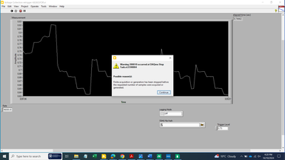

I tried to run at higher sampling frequency and got these errors...

One main thing you're "doing wrong" is defining the # finite samples to acquire to be 250 in your call to DAQmx Timing.  For each triggering event, the task will want to collect 250 samples before it will rearm to look for the next trigger.   Given your description, you should configure for 2 finite samples per trigger instead.
However, when you expect 360 triggers per sec that means you need your reading loop to execute in < 3 msec consistently.   Under Windows, you can't expect 100% success at this.  If execution gets delayed, I *think* you're going to miss out on retrieving that trigger event's worth of data.   The hardware retriggering will want to keep restarting the task and writing data into the beginning of the task buffer over and over regardless of whether your software has yet managed to read the data that was there from the prior trigger.   I can't test the behavior now, so it's possible DAQmx will throw a warning or error, but I'm not sure.
So even though your X-series device *can* do retriggered AI directly, there are still some possible advantages to the scheme I laid out previously for your M-series device.   (Revisit the whole thread for some followup corrections & further troubleshooting suggestions).

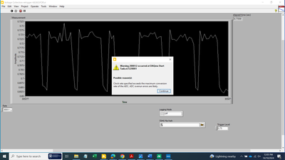

I apologise for the delayed response, and thank you for your previous guidance.
I am currently using the NI-6363 BNC and screw terminal with a retriggerable approach to capture points from a multichannel analog input (AI). However, I have encountered an issue while trying to run my code at the maximum sampling frequency (500 kHz for 4 AI channels) in RSE mode with finite sample mode.
At the maximum sampling frequency, the system does not appear to follow the expected falling and rising behaviour when using the hardware retriggerable approach with a 100 Hz trigger signal. Additionally, I observe transient behaviour in the raw data, which raises concerns about whether my code is functioning correctly. It seems that these anomalies may be causing the transient data and preventing proper adherence to the falling and rising behaviour at high sampling frequencies.
I have attached the code for both the hardware trigger retriggerable approach and the counters approach. In both cases, I am observing the same type of data.
I would greatly appreciate it if you could review the issue and provide your guidance on resolving this problem.

I might be able to dig in for a closer look later on today, but in the meantime, can you show an example or clearly describe what you think the data *should* look like instead?   And discuss *why* you have that expectation?
I don't know anything important about your system so it's pretty hard to interpret "anomalies" in the data when I don't know the difference between normal and abnormal data.
What would be really helpful is an untriggered capture of normal data.  Then draw in vertical lines to show the region that *should* get captured when triggering operates correctly.
