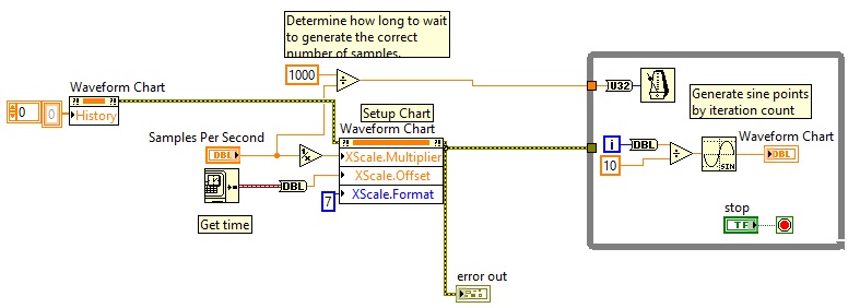

Okay, I've reached my limits.  I've followed the example given here to put the correct time on the X-scale during runtime.  Still not working.  I have my waveform chart in a separate while loop.  I "think" that is the problem but I don't know.  I tried putting it in the main While Loop and that didn't work either.  I've been working on this off and on for two days and it's the last part of this little program I need to get working.  Please help.

You are correct that I'm obviously still hazy at times on how data flows in LV.  Knowing that the second While Loop is dependent on the first exiting, now the data flow makes sense and why my stuff isn't working as expected.  The outside While Loop where the chart is located on the block diagram needs to be in a separate thread....or task.... or whatever Labview likes to call it if this is to work like I want it.  I'll edit the code and see how that goes.   Thanks for the tip with showing the enums with meaningful names.  That works a lot better!!
With that said, what should be simple (standard with charts and graphs in my opinion) functionality with time on the X-scale work like they show in the example link I posted, it should not require any coding on the block diagram.  It should work like their example shows straight out of the box, and then if the programmer wants to change it and how it functions they can.   I mean I have to do all of this on the block diagram....

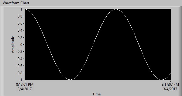

Just to have time display on the chart on the front panel like this (a standard format on most software with charts and graphs I've seen).

No, I'm expecting a Waveform Chart or Graph to work in a standard, default fashion right out of the box.  That default being that the X-scale shows correct system time when I make that selection in the chart properties for the X-scale.
So, when I wire some data flow to a chart on the block diagram, it works as shown in the provided NI example, no additional coding required.  That should be the default way of it working.  What I don't get is that NI gives you the option to show absolute time and system time and format the X-scale like that in the Chart properties options.   Great, cool beans.  So, I get the chart properties all set up thinking, "Oh, nice, this will be easy".  It's supposed to be because after all, it is LabVIEW. Then I start my VI and yes, the time is formatted like I want it!  Great.  And.... the time is incrementing just as it should at both ends of the chart as the data is being streamed across the chart.  Nice!  Uh-oh.....but wait just a sec, there appears to be only one "little" problem.....the time is wrong!?!  So I think maybe I did something wrong being that I'm not a polished Labview guy.  So, I check the X-scale properties of the chart again (for the n-teenth time).  Yep, I've got it selected for absolute time, system date format.  What's the problem??  Why is the time on the X-scale displaying an incorrect time??  Reading further in the help files I learn. Oh, it will display the time on the X-scale in your selected format and it will even increment the time at a precision you choose, but.... you have to code the correct system time for it as it doesn't automatically show the correct system time.   And that coding involves what I posted in the picture above.  Smiley Frustrated  Ridiculous.  It shouldn't be that much for something as simple as that.
