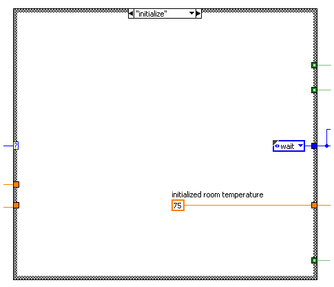

Thank you very much, it's even more than I needed and it represents an improvement of the thermostat control, just one question, how did you go about saving the initial room temperature? Could that be controlled like the desired temperature??
(8,335 Views)
if you look in the initialized state case, you will notice a random number function connected to a DBL 100 constant. This will generate numbers DBL ( 0 -100). you can change that and just put whatever constant you want to start room temp. at, for example this code will always set room temp to 75 ....
Spoiler

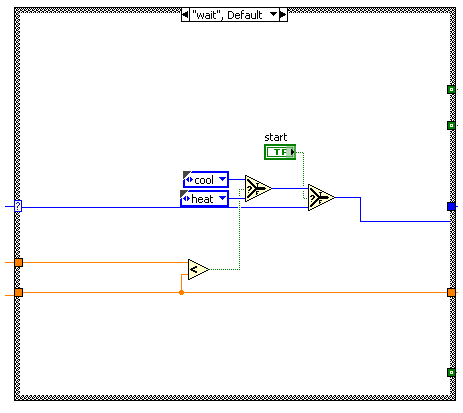

sorry for the bad code....exchange the wait case for this
Spoiler

Good day! Thank you for this system, it's really good. Is it possible if you could explain what you've done here briefly? Especially in the wait section with the select section (referring to the updated version). I'm very new to this software and still getting around the workings.
A brief explanation as to how this system works would be really appreciated!
