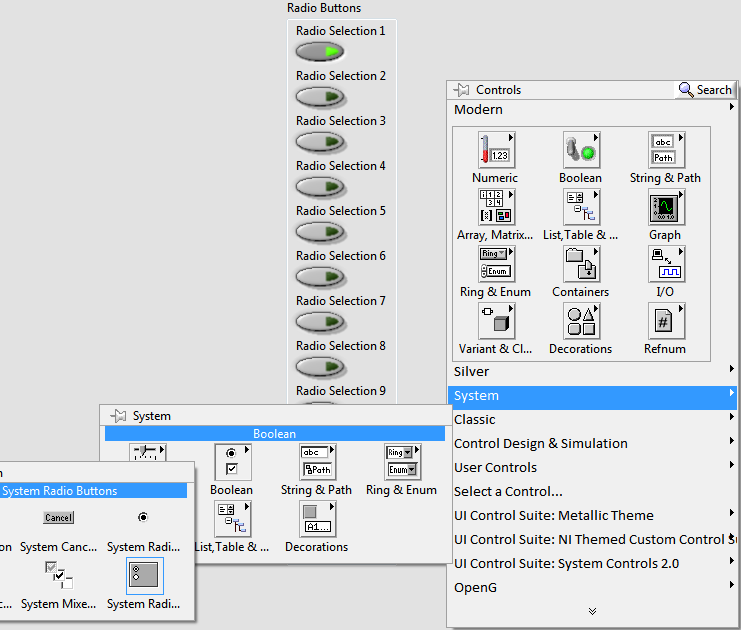

Hello Denny,
You can use Radio Button with enabling the function "Allow no Selection" by right clicking on it.
for your reference I have attached vi, just go through it once.

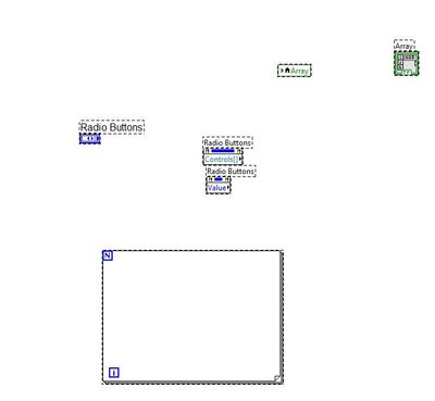

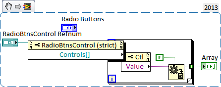

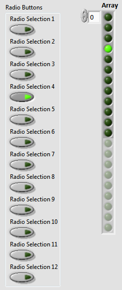

Yes Denny,
You can get the the actual valye of this booleans in to a array of boolean. you have to just follow the step as I have shown in this below image.
Vinal Gandhi, CLA

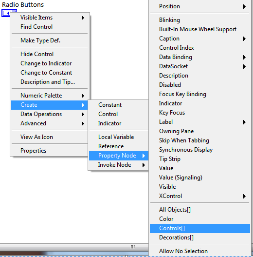

Hello Denny,
you just download the snippet (Block Diagram image) and drop it to your VI's Block Diagram you will get the samre code in your VI, this is the one of the feature of LabVIEW.
Here I have taken "Controls []" property of radio button, which you can get it from this path at block diagram right click on radio button>> Create>> Property Node>> Controls []. Same wave you can take "Value" property box also.

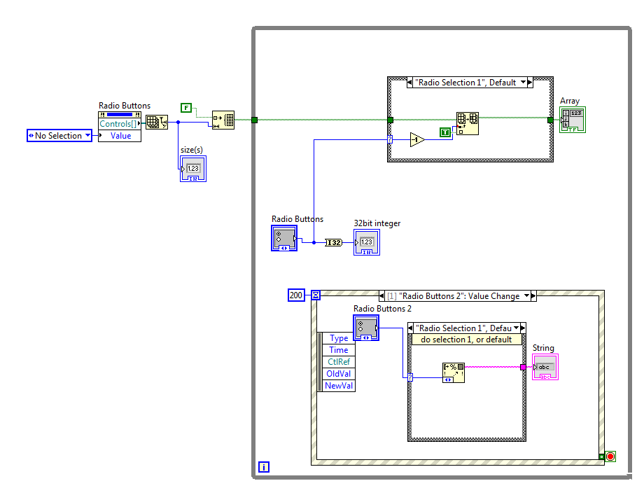

here is another method to react on a radio button:
the top solution creates a boolean array, the lower is how I would use the radio button: the event case just react on the change of the value and the output of the radio button control directly enters a case structure 🙂

I really appreciate you help, but im sorry I still have difficulty understanding what to do.
I have tried draggin the image from your second post to the white board and it just copied an url address.
Also , I have followed your instructions from your latest message, and created the contorls[] and value and now i have this:
and i dont know how to procced.

When I try to change the name of the Radio selections ( i need to have different names) then the "no selection" connection to the value gives me an error.
What can I do?
And can you please explain me the meaning of this connection?
Thank you very much.
Message 9 of 10
(8,765 Views)
the 'No Selection' is only valid if you have set to radio button control to 'Allow no selection'  (rigth click in the FP on the radio button frame ...)
If you rigth click the case 'name area' you can create new cases that are already correctly named. You can choose one case to be the default case, or you have to create one case for every button (plus the no selection if aktiv)
