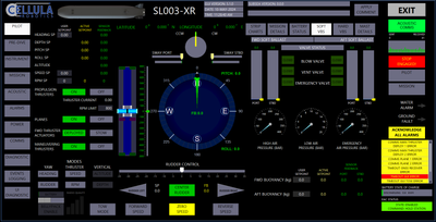

I am the sole LabVIEW developer in our software group.  At one point we used LabVIEW for everything, but have transitioned to other frameworks.  Now we mainly use it for UI design.  An example is pasted below.  This UI consists of ~90 different panels, 1000+ Sub-VIs, and many custom controls/indicators (usually using 2D Picture controls).
