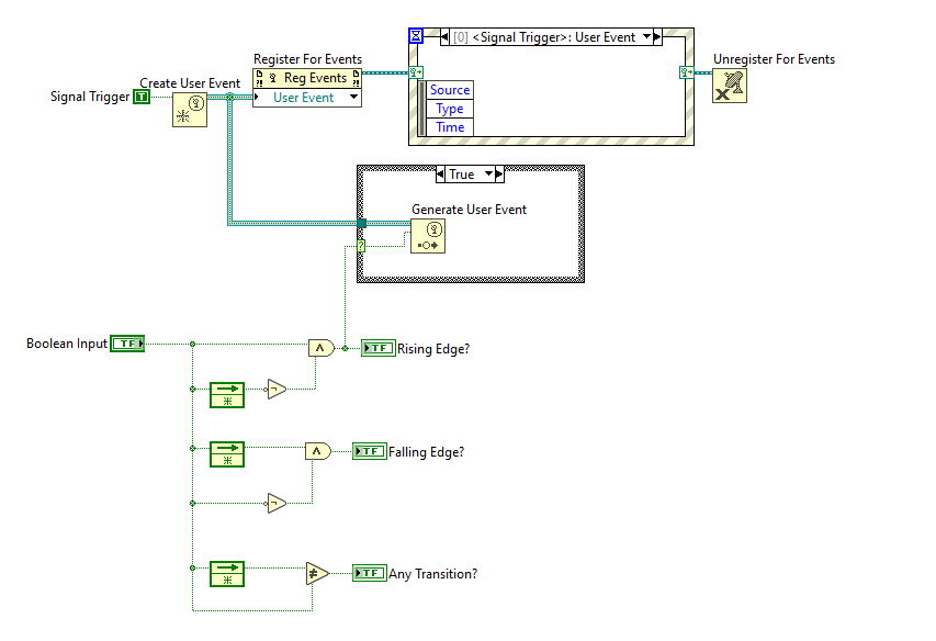

You need to test for a change of state of the signal, and only then generate the event.  Like this:

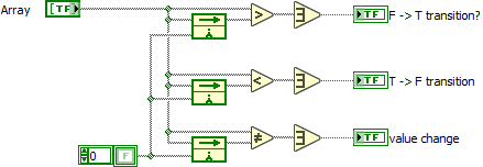

You can create a dynamic event (also called user event), that is only generated when the desired transition is found. See below for a couple different bits of transition logic.

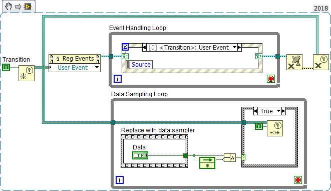

Using comparison functions is simpler and makes the code easier to read and understand. 😄
(of course the global init value depends on the situation, so modify as needed)

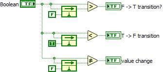

@rolfk wrote:
I would disagree! 😀 Boolean logic is clearer in my opinion than a comparison
Yeah, I disagree too.  I don't find > or < comparisons for Booleans all that intuitive.  I can recall a time when I was first programming where boolean True was represented by the value -1, which would make that comparison logic wrong.  In retrospect, I'm guessing that the underlying integer datatype turned all bits ON but the language default was to treat booleans as signed integers.  In 2's complement, a signed int with all bits ON = -1.
I tend to make heavy use of the "Compound Arithmetic" function, both because it expands to multiple inputs and also because the input and output terminals can be inverted individually.   I also tend to force my "transition" detection to return a False on the first iteration.  So here's what I'd be inclined to do:

I usually wire the Init input from the Feedback node to the input. Seems to have the same effect but avoids to have to think about the value of the boolean constant depending on the slope you want to detect.
