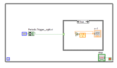

I want to know how can I make a periodic trigger without using the "periodic trigger" from the OpenGLibrary if labview, on windows 7 machine with labview 8.5. I want to trigger a case structure every 500ms.
As a note, I am able to do this using my Labview 2013 version on windows 10 by downloading the OpenGL library, but at college they are more limited with their Versio 8.5 Labview and I would like to use the default libraries.
I also attach the .vi I managed to make on my 2013 Version Labview.

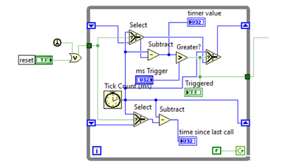

Thanks.
This is it, in case anyone needs it:
(1,734 Views)
Note that there's a subtle "off-by-one" error in the openG function.  Change the ">" greater-than comparison to a ">=" greater-than-or-equal to fix it.  I'm pretty sure I tried to report it into the openG dev forum many years ago, but never followed up further.
-Kevin P
