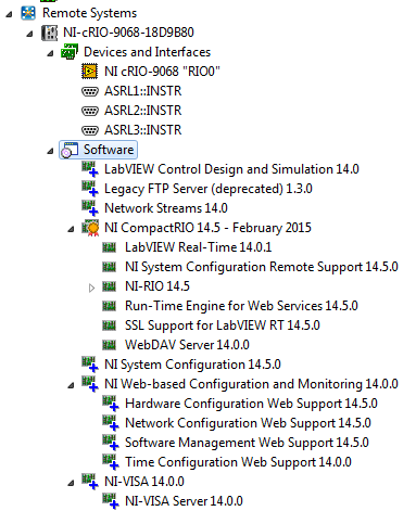

I am running LabVIEW 2014 sp1 (14.0.1) and the attached images shows the software installed on the cRIO. My host computer is Window 7.
