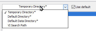

Yes; my LabVIEW, Options, Paths look like your screen shot.
